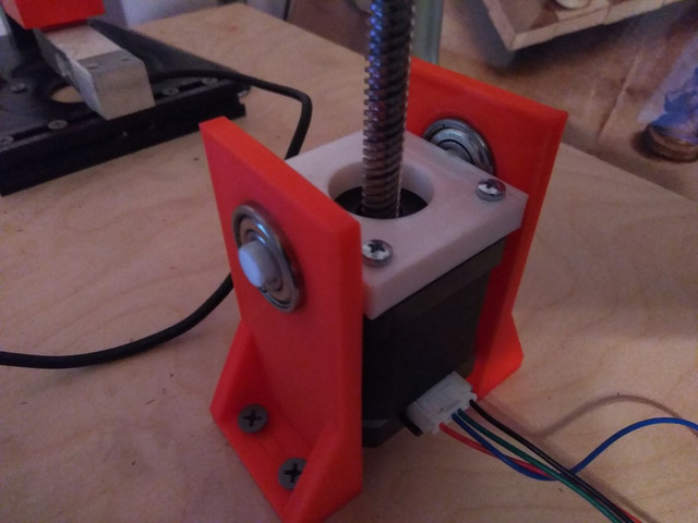

Stepper motor. Nema 17 with 300mm 8mm lead screw. Two skate board bearings for pivots. Few 3D printed pieces.

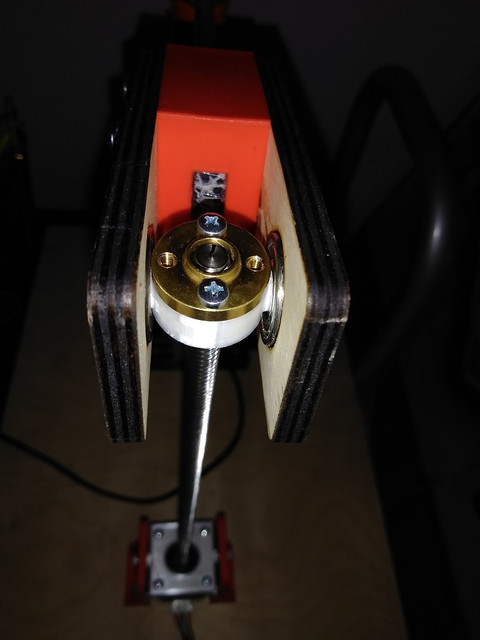

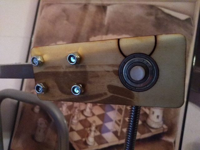

Next two pictures show the attachment I made to the handle of the press. The brass nut that came with the Nema 17, couple more skateboard bearings, 3D pieces to hold the brass nut and to attach the laser cut wood to the handle.

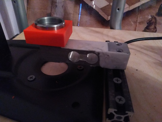

40 kg Load cell bolted to a piece of 2020 aluminum extrusion. Couple 3D printed pieces to hold the cup for the seating die.

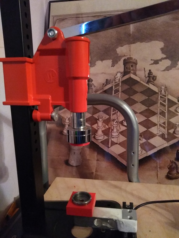

Finally my "arbor press". A beer bottle capper that I repurposed. Another 3D printed piece to hold the top piece of the seating die.
