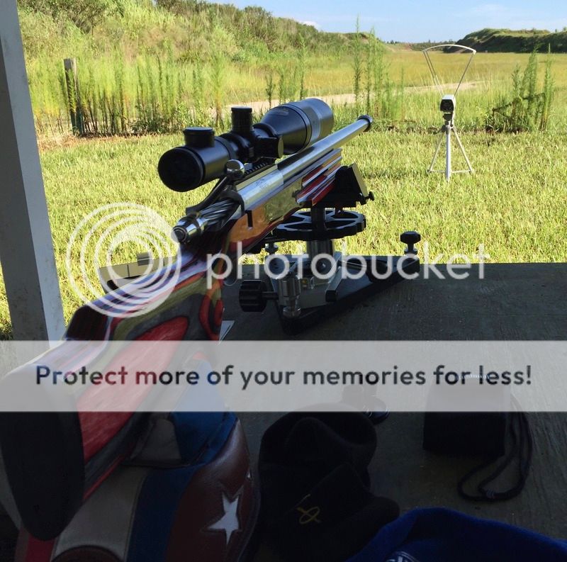

Had Eric Bostrom build me a new dasher with the old reamer specs. on a Stolle Kodiak action using a Bartlein ( from Bullets.com) 7.5 twist and his new-style ARS tuner.
Broken in with 21 choreographed shots and Lapua brass, I got 3051 fps with 33.4 gr. of Varget and NO pressure signs. I accented the "NO" for a reason. Also got .4 MOA during some of that shooting.
