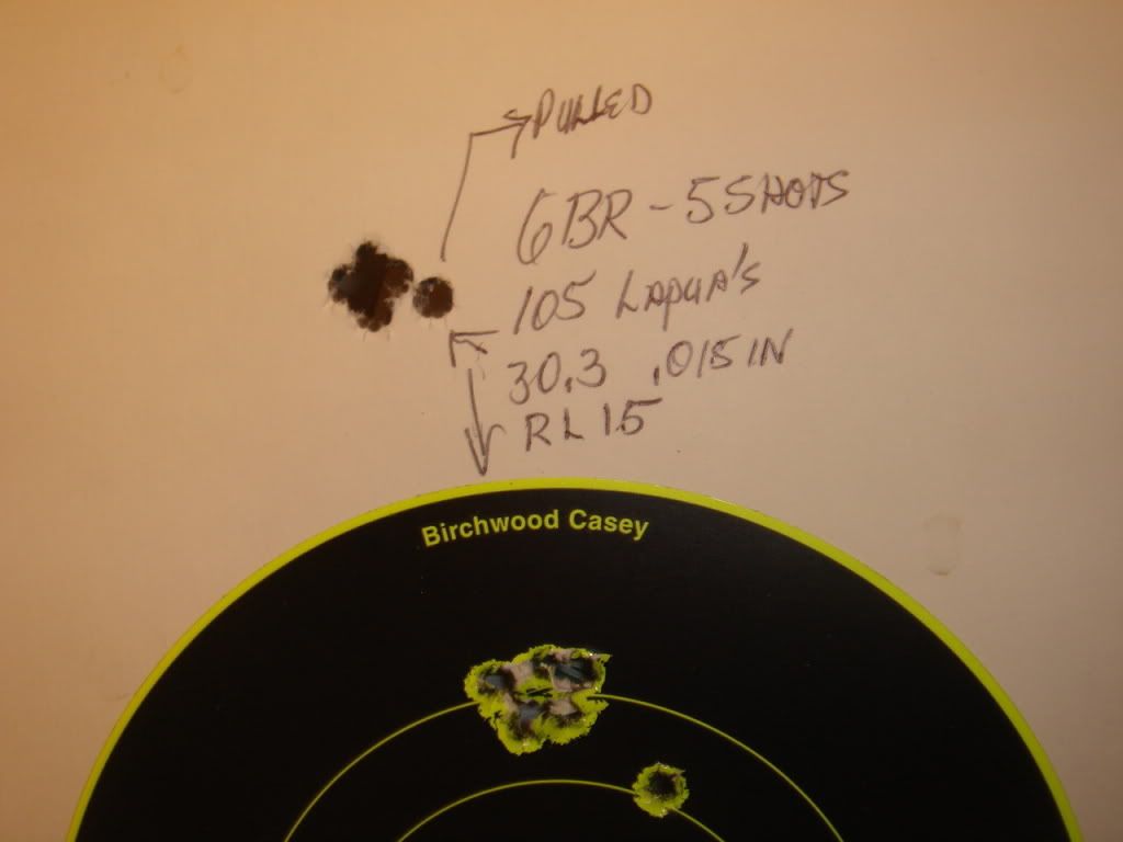

    new load in my weatherby vanguard 6BR 1;8 twist 30" krieger HV using 105gr berger hybrids and 30.6gr of 2208/varget running at ave 2939fps ES of 9 and a SD of 7 with CCI BR4 primers in Lapua brass no turn .272 neck and 105 freebore seated .014 off lands
    500m or 547yards 1.865 inches
    1st group was going to be a 1.8 inch group also put i pulled the last shot
