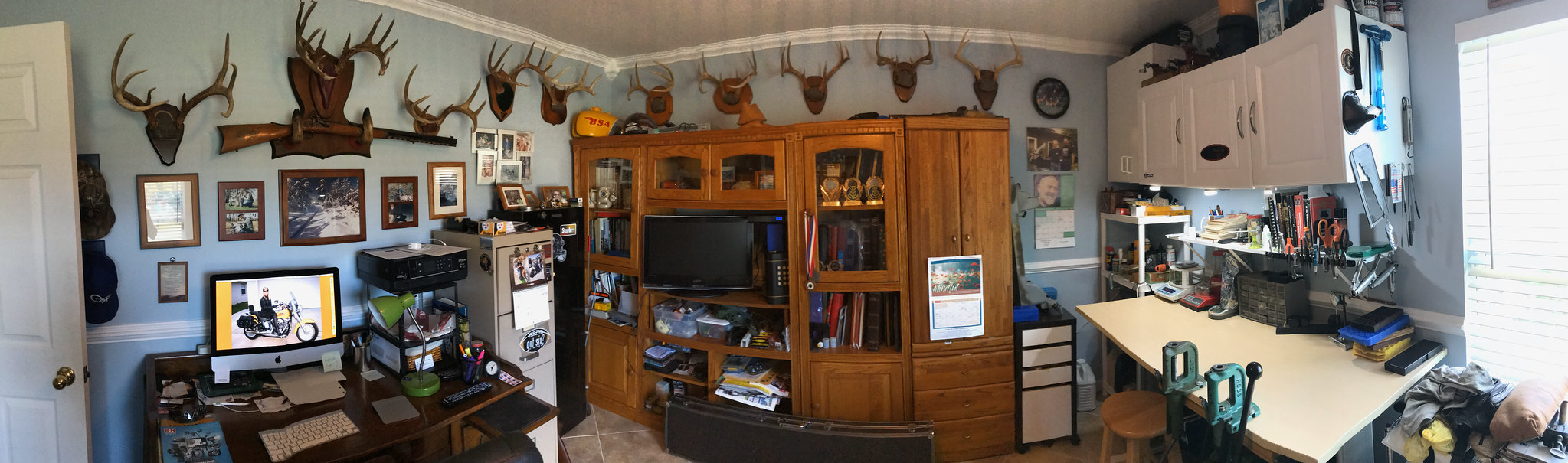

@Papa Charlie , though I am leaving my "everything" space/man cave the computer and tv are going to be left behind. If I am in this new room it will either be reloading or working on a gun or doing typical work bench stuff. Pictures will be uploaded soon and should only help in getting my point across. Room footprint is 11' wide and 8' long (usable work space without bench) and being that both benches would be out 24 and 30 inches without shelves I planned on putting recessed lights about 24 inches off the walls and spacing about 30" apart. There would also be 2 recessed lights above my built in shelf on the outside bow window. Last I planned on having 1 fixture in the center of the room utilizing traditional 60 equivalent bulbs to help flood
Current reloading room/ gun room/ office soon to be play room/office. Don't mind the mess

Pictures of framed out space. Picture with vice is the reloading side. Picture with grinder/ old bench with be for other work bench.

I use many 100W equivalent LED lights. I use a dehumidifier in the spring when the air nor heat is on much.
Build a bigger reloading table than you think you'll need. And build a bullet shelf the same way.
Organization is very important.
For me, white walls would be too bright. Thinking sore eyes as they would never get a rest. I have 4' LED lights above the benches and tan walls. Its like a lighthouse inside so I can see what I am doing, but the mellow tone walls make it so the room is not intense.
Thanks all for the insights. I would just like to ask specifically about lighting and whether I should use the recessed lights/ led bars/ or conventional light fixtures.
@jonbearman Excellent point on vapor barrier. I am going to insulate on craft backed r-13 plus a plastic vapor barrier on walls and ceilings...my wife is very keep to smells and I sprayed some pb blaster in the same room to free up wheels on an ancient floor safe and she complained about it days plus had me leave the window open in the bedroom at night.
I would do recessed (can) lighting unless you are looking to stack them tight. You will want a widest throw over the bench that you can get.
I have recessed lights also. You'll want a standing light also, so you can have extra light if/ when you need it.
I'd stress install more recessed fixtures than you think you'll need, maybe on two or three different switches. It comes in handy!
I personally find more light better than low light. Especially in a basement.
