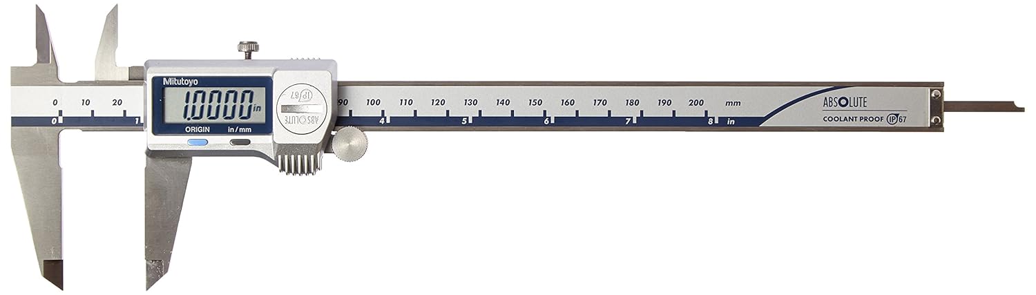

I've been amazed by the new Mitutoyo 500-753-20 ($240 minus 25% shipped free from Zoro.com) which is an 8" ABSOLUTE built to IP67 specifications. I actually had a chance to try and drown one set before I bought mine. IMPRESSIVE. To see it do all the same return to zero and hit measurements on the head while under a torrent of water was an eye opener. Dunno what to say on your other choices. I used and still own Etalon Dial Calipers & Micrometers and still consider Interapid Test Indicators the best/though Mit 513-402-10Es on my Accuracy First Concentricity Fixture are impressive(the newest models mentioned below). That being said I have realized two things this year courtesy of my eyes.. The future of metrology is without question Digital and Mitutoyo is the world leader when it comes to digital calipers and mics(imho & fwiw). Especially whey are nearing middle age and need readers like I do...;-).
Old model with much complained about battery door...
New model with o-ring screw in port. 8", IP-67, .0005". $240 - 25% and shipped for free... 6" version comes out to $120 also IP-67. Most don't need IP-67, however, if you had enough old digital items die from humidity, to say nothing about full immersion, you will likely go home with a set in another black box with orange cover like I did...
THE thing I like about Mitutoyo, other than the deals that Zoro.com runs once a month if you order enough, is that they are CONSTANTLY improving the product. I heard AD NAUSEUM about the "little door" on Mitutoyo Digital Calipers that needed to be improved. Fast forward a few months and there is a new twist in round "hatch" style door with an o-ring that is, obviously, water tight... Water tight like you would not believe. The are so new most dealers have the OLD pictures up. As a matter of fact I have run into that several times with Mitutoyo. Constant improvement. I wound up with two new test indicators this month that I thought were chinese Mit knockoffs as they had different markings than ones made 6 months ago. Mitutoyo USA checked with Mitutoyo Japan and confirmed it was one of the newest indicators that came standard with a graphical certificates of inspection. Who can complain about that?
