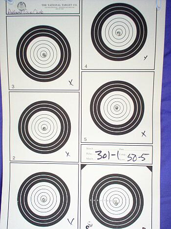

Has anyone ever seen a 7mm-08 shoot like this?
