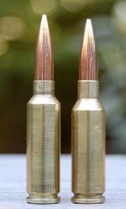

It's based off the Grendel case
Yes fireforming is required
Capacity is close but just a little less than a BR
PPC bolt face
Custom die
Bart or myself will get a picture posted sometime today
