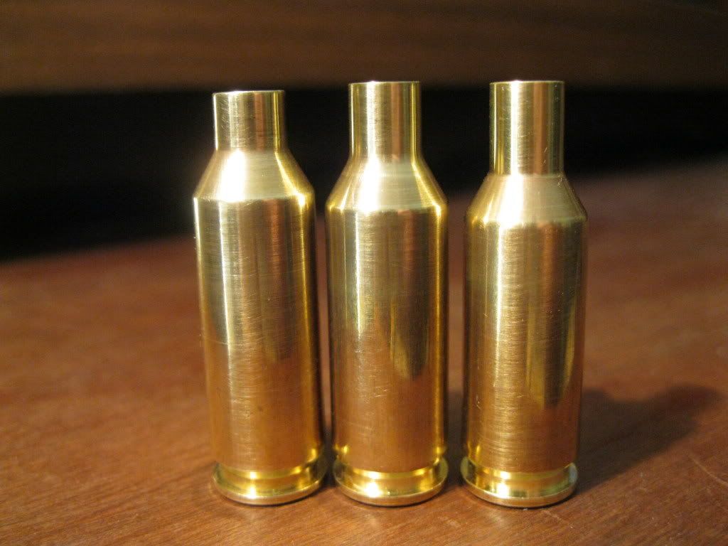

Far right standard 6BR, the left is the 6BRX in the middle is my newest chambering 6BR-TC.
I shot this today after initial fireforming and was very pleasantly suprised.
I like the longer neck and the bigger engine compared to the 6br. I have a 6brx and love the heck out of it. Keep the forum updated on it, I would like to know about it.
I would like to see it next to a dasher size wise. But I like it. Of course you show me this after I got my BRX built. Keep us updated.
Wayne, this is much shorter headspace than the Shehane and maintains the original 30* shoulder not the 40* on his design. I can use 6BR dies just like the 6BRX.

Nice looking, your picture makes it look like half the BRX blown forward or
.050, So how far did you blow the shoulder forward?
What dies are you using for reloading the 6BR-TC?

Thats exactly what I decided on. I wanted to use 1/2 of the BRX and keep 1/2 the BR neck length. The pics show this quite evidently. It is a BR +.050". I wanted to be able to use 6BR dies for this.
I wasn`t sure about doing something so similar to the BR-DX, but what pushed me this way is I e-mailed 2 of the best shooters I know and asked them their opinion of the BR-DX and neither replied.... :) This was quite "out of character" for these guys soooo I knew I was on the right track. 8)
