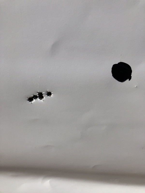

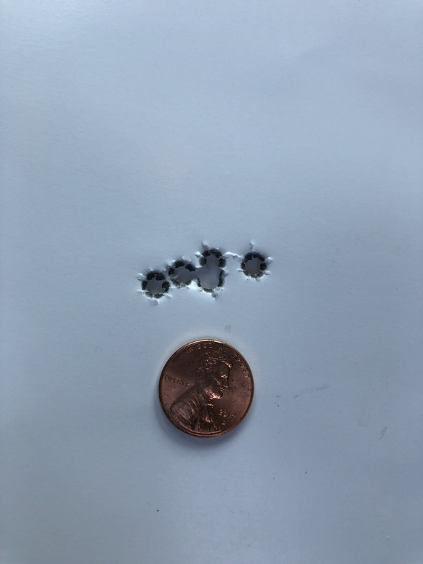

    Today I shot a seating depth test fire forming 6brai brass and this little jewel popped up...606yrds 30gr of Varget 105 Berger hybrids .003-.005 in the lands (I'll have to go back and measure to be sure) barrel was chambered by @Cigarcop at KW Precision.

    Now dont freak out when you have to tune the gun to get it back to shooting that way. For some reason fire form loads can be very forgiving to powder charge. If it does it fire forming, it can do it on formed cases, but now you'll have to find it. Nice shooting.

  9. Curious
    Curious
    Joined:
    Nov 23, 2016
    Messages:
    187
    Something to do with softening the pressure spike maybe as the brass will give as it starts to form at the same time as the bullet starts to move?
    This might also explain why running a little extra headspace can be more accurate than less?

  10. Alex Wheeler
    Alex Wheeler Gold $$ Contributor
    Joined:
    Feb 5, 2011
    Messages:
    5,967
    That may be the reason some have tried more sizing in the first place to see what it would do ;)
    And I would agree, I have been meaning to do it, but I think a sine wave target would tell alot while ffing. I am guessing the pressure spike is not sharp enough to get the barrel into the harmonic pattern we are used to seeing.

    I wonder what Rope2horns is using for a scope to see that little dot at 600 yrds
  13. Rope2horns

    Messages:
    376
    NF comp and that's a 3/4" black dot on a white background stands out well for me.

    1,076
    The old 4" diameter penny trick, again?
