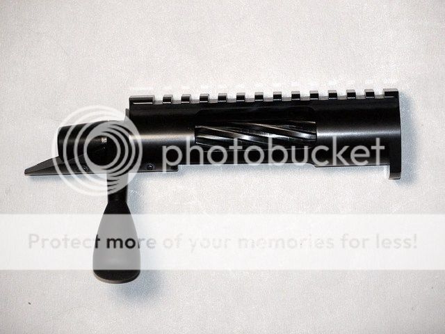

Well, I started with this:
130 Berger VLD seated about this much in the lands at 2.735" OAL to start load work:
I don't think there's a better place to start, that VR is bad Azzz. The ignition system is as good as it gets along with the small pin it's a perfect fit. I went with more FB, but i only run 140's.
I feel the 47 is better suited for 123/130 range of bullets, unless you run a looong barrel...o_O

I knew out of the gate that I wanted to shoot Berger 130 VLD's, and based on past experience with the 47, Varget was the powder of choice. However, the barrel is always boss.
I was not to be disappointed........

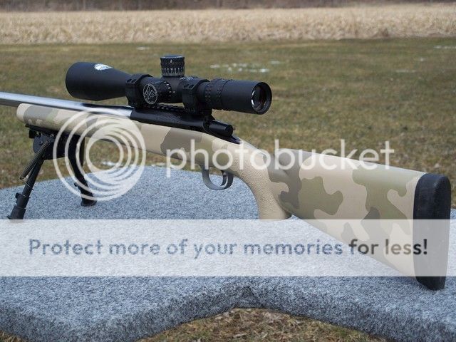

Yes Sir...it's finished at 28" went with a bartlein 5r MTU sitting in a manners t4 mini chassis fed by a BigHorn tl3.

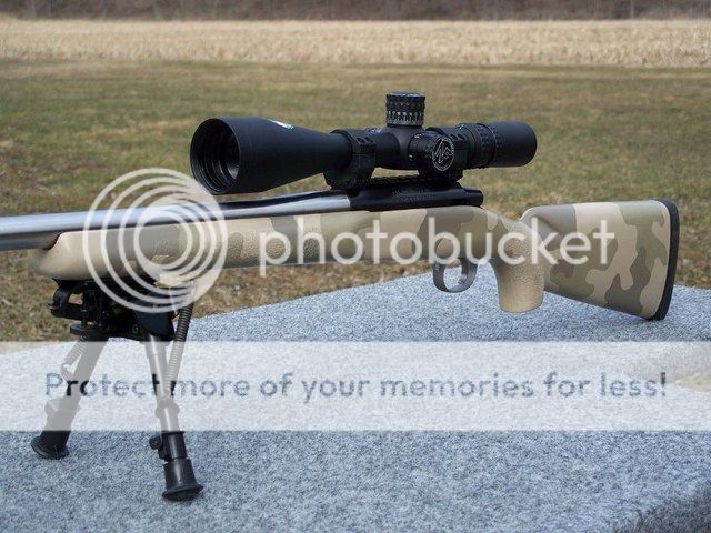

sure is a sharp rifle you put together,,
