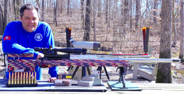

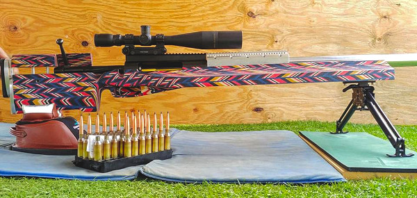

All Three men used the .416 Barrett to Win.
Absolutely !!
