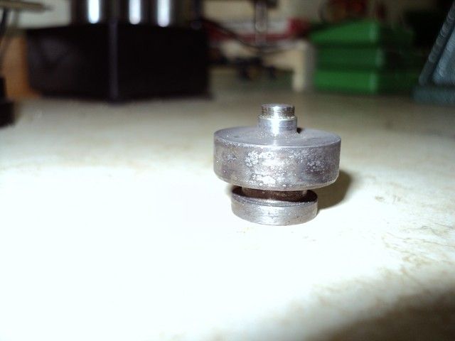

I was talking to a buddy (GT) and he said he has the fix for this! He sent me these pics and specs and said HR made him "nubs" for both LR and SR pockets! So I had HR make me a LR one!
The tool, basically pushes, via a loading press, a small amount of case base material from around the edge of the primer pocket hole into the hole itself to create a small ring/ridge in the primer pocket to hold a primer tight again.

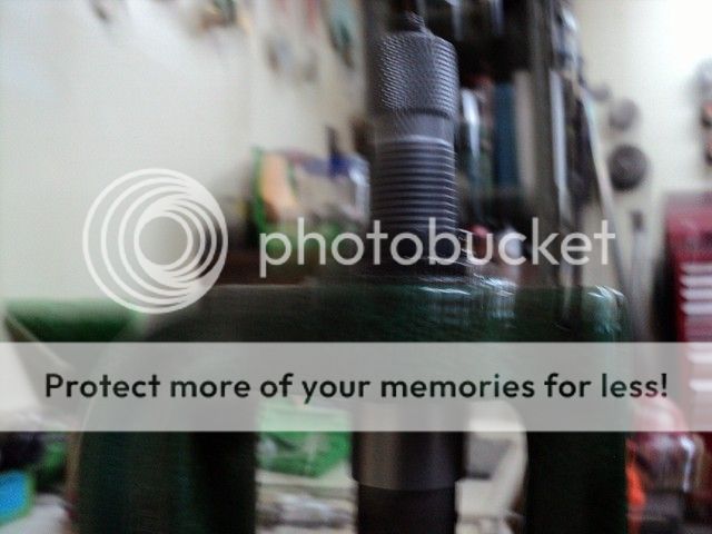

You need a pocket swagger die to hold the inside of the brass down while pushing the brass into the primer pocket hole.
RCBS sells one for removing military crimps from pockets...
Put the tool in the press,
place the case remover collar over the tool,
put a case on the tool, (you have to raise the ram some to have the tip stick thru the opening of the removal collar)
stroke it,
and you get...
This works! Holds primers like new again or even tighter! Loose pockets go from 0.207-0.212 to 0.2045 to 0.2055 and primers stay in them now. I reloaded and fired 30 of these "fixed" cases a few days ago, in -30 C weather and none leaked and all required good force to de-prime them again!

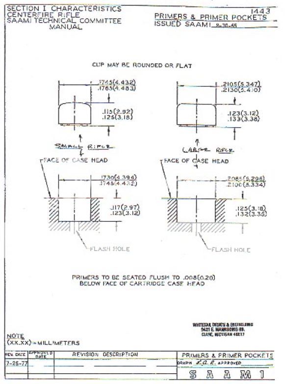

Here is the SAAMI drawing for primers and pockets...

How I set this tool and die up.... place a case on the tool, raise the ram all the way up, screw the dies down so it has lots of threads in the press to hold things, and screw the center rod down till it touches the bottom of the stroked case, lower the ram so you are just before or starting into the cam over, screw the rod down to the new location. This setup allows you the power of the cam over to push a small amount of brass into the pocket hole. You will need some force to remove the case from the tool or your not pushing enough material. GT says he just does it "by feel" because you can feel the brass moving.

HR made my "nud", he can be reached at henry.rempel@hotmail.com or you can have one made, see the 1st pic in my post. RCBS makes the die and rod aka primer pocket swagger tool-2 pn 9481 (fourth pic in my post). Once you heat treat the "nub" the dimensions will be a few thou smaller, my top tip is .2045"
Henry has a few extra's made up already in SR and LR so contact him and he can fix you up!

The one you get with the RCBS swagger has rounded edges to push the mil crimp into the pocket and has a smaller diameter, this tool has square edges to move the brass into the pocket. I have used the RCBS one to swag the hole bigger after I really moved a ton of material and could not set a primer in it.

Too easy too make yourself too, give the first pic to a machinist and have him make it, then harden it and use oil as the quench so it goes to about a 55 rockwell and then buy a RCBS swagger 2. Comes in handy for the ones that are too tight to swag them back up a hair using their nub with the rounded edges.
