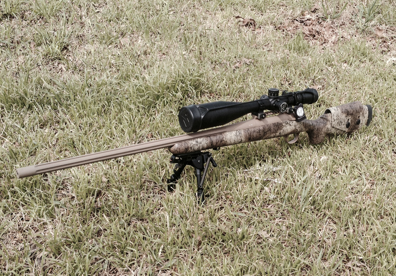

I finally got some range time with my new .20 Beggs. I am running low on H335 so I worked up a load with Viht N133. I load test at 200 yards. Batt action and Hart barrel. I went with 1:9 but I kind of wish I had gone with a little higher rate of twist for the Berger 55's that I have a pile of. Since it's shooting sub-1/4 moa groups at 200 I might not need any faster.

The rifle (built by Defensive Edge)
