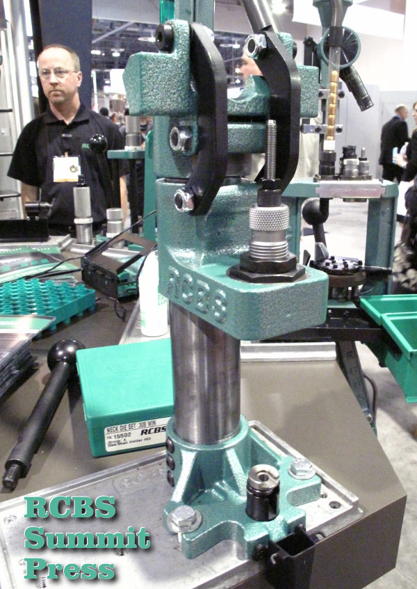

RCBS SUMMIT PRESS
« on: 01:47 PM, 07/11/13 »
  • Reply
  • Anyone have one and how do you like it? I've read the reviews but would like some one on the sites opinion. Constantly on back order from Midway.

  • I have one. I like it OK. I haven't conducted any particular tests. I believe that it flexes quite a bit, and it is heavy.
    The one I received none of the screws/bolts were tightened. The ram flexed visibly, so I went over it and tightened all of the bolts. I believe it still flexes too much. My evidence of this is that I have to thread in a Lee FL sizing die 1 1/4 turns to get the shoulder setback where it needs to be. It may also be that I just need to tighten the bolts on the linkage further, I don't know.
    The amount of force required to size 308's is quite a bit more than I would have thought would be necessary.
    It seems to me it should just work, out of the box, rather than have to be tinkered with. I haven't given up on it yet, but in truth, I am disappointed. In its favor, it doesn't hang over the edge of the table.

    I wish to convey to other contributors that this press is working very well for me now that I have figured out the issue. In fact, other than not having been properly torqued down from the factory, it never did have an issue, it works fine. I had determined to tinker with it until I had it figured out, and it has turned out that I needn't do that. I am very happy with this press.
    Heck, the primer catcher alone is a plus, as it catches *every* primer. It must be emptied frequently, but it doesn't spill. :)
    I wish to explicitly retract my statements concerning the degree of flex I experienced with the press, as it was caused not by the press, but by brass fired in a short chamber being too short to properly resize in a standard FL die. I do not wish for my errors which attributed my problems to this press to put someone off from buying a really nice tool.

  • I doubt that the column itself is flexing, more likely it is the castings that it are attached to at both ends., but in the end it doesn't matter which it is. It seems that we have come full circle. From open frame to O to open, and back to O. They all work, they just have individual characteristics that will determine which you choose. I have a turret press that I like for some applications, but it flexes more than an O press when FL sizing. I compensate by the die adjustment. Big deal...

    A friend bought one, after we cleaned the grease off the thing, and played with it, got dies set etc. I was impressed, it acted as though things would self center, on the order of the co-ax press. Talked to the guy days later, he informed me while sizing about 500 pieces of brass, all the set screws came loose, the ram was loose, and other key parts. I had to see this, after inspection, there's set screws in places one can't imagine!!
    He retightened stuff, I asked if he centered stuff with a die and a case installed, he said no, I don't know how you could realign things without some support?????
    I'm going out on a limb here, but for something that seemed to have a ton of promise, I would look for something better.

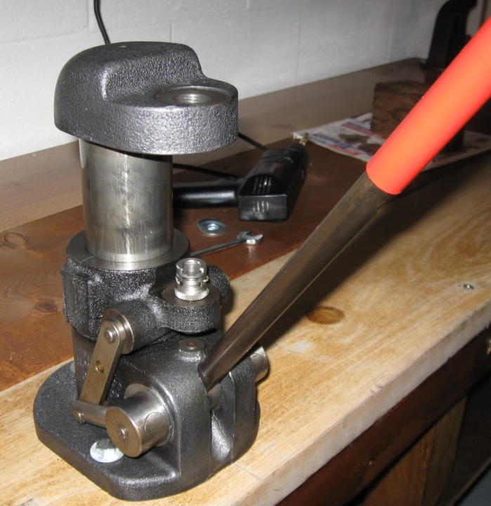

    Mechanically, it is a copy of the first Hollywood press of the late 1940s (which failed, even then).
    When I first saw the Summit, I was astounded that RCBS would go backward like that.
    It is a single "Knee" leverage system, with less than 1/4 the power of the swinging compound lever system of the RockChucker (and a whole lot cheaper to make), and it has more spring and flex than a "C" press...
    ... and unlike the old C presses and the original Hollywood of the past, there is no way to brace the front of the press to give it rigidity for tough chores.
    It looks kewl, but mechanically, it is a big step backwards.

    We have been using one for a month and encountered zero problems
    -- Plenty of power to size cases. Plenty.
    -- "it has more spring and flex than a 'C' press" -- I have no idea why this is suggested. The press we have is plenty rigid. We are holding tolerances as well as an "O" press, including base to ogive and concentricity measured on the bullet. The die-holder head moves straight down. Makes straight, repeatable ammo. We have not encountered a flex problem. See for yourself in the video we put up.
    -- "It is [too] heavy" -- Compared to what? It is lighter and smaller than a rockchucker and is much more portable.
    -- "Mechanically, it is a copy of the first Hollywood press of the late 1940s... unlike the old C presses and the original Hollywood of the past, there is no way to brace the front of the press to give it rigidity for tough chores" -- This press is NOT a clone of the Hollywood. The Summit moves the die down to the cartridge, not vice versa. The two mounting bolts for the press are in the FRONT. The press is very stable.
    In this instance I suggest that individuals who have not touched the press, installed it on a bench, or loaded a single round on it reserve their UNINFORMED negative comments until they have first-hand experience actually making ammo with the Summit.
    NOTE: I am NOT referring to those who have actually tested the press and found it not to their liking -- their comments are welcome. Although based on the unit we have used, I am somewhat puzzled at some of these comments as well.
    The bottom line here is that the guy who did our review likes the Summit so much that he plans to use it alongside his RCBS Rockchucker IV. If Mark didn't really like the Summit press it would be back in a box on my doorstep. He is keeping it and using it to load match ammo.
    Summit Press (Die moves down, links not hinged in middle)
    Hollywood Press (Cartridge/case moves up, completely different kind of linkage)

    There certainly can be variances in production line tolerances and assembly quality that might appear in some units. Maybe we got a "better than average" Summit. But I also wonder whether some of the "early adopters" who aren't happy have installed and lubricated the press properly. All I can say is that we loaded ammo with the exact same dies (and components) on both a Rockchucker and a Summit and we were very pleased with the results from the Summit. As with any new product, we were skeptical. But the press actually exceeded our expectations. Comparing Rockchucker vs. Summit:
    Control over headspace (shoulder bump) -- no discernable difference -- both excellent
    Uniformity of cartridge base to ogive -- no discernable difference -- both excellent
    Concentricity of loaded rounds (measured on both necks and bullet ogive) -- no discernable difference (.002 average on bullet with both presses)
    Ease of Use -- edge to the Summit because of open front, compact footprint and simpler, more reliable spent primer capture system.
    Results on target -- In F-Class matches, higher score was shot with Summit loaded ammo (but of course there are many other variables at play.) We certainly saw no evidence that any ammo accuracy was sacrificed with the Summit.
    I should add that we were loading for the .284 Winchester with dies that provided a very good match to the chamber and rounds did not have to be aggressively FL-sized. Perhaps if someone is trying to resize blownout brass from a SAAMI chamber a press with more leverage might seem better. But as far as we were concerned, there was no need for more leverage whatsoever.
