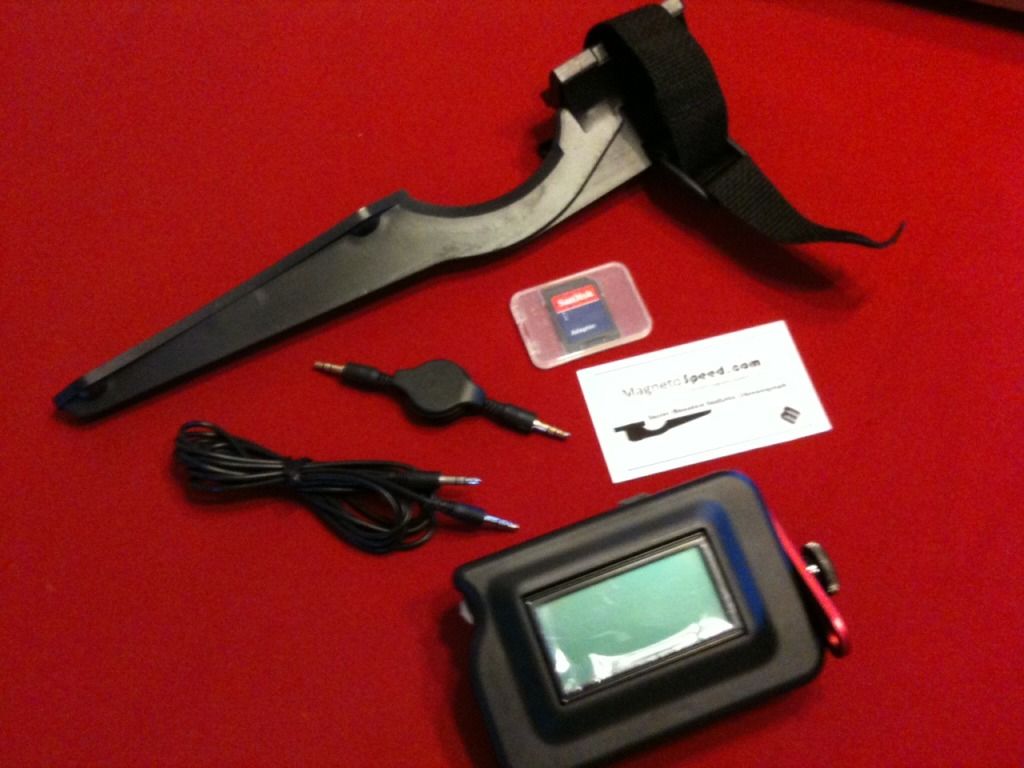

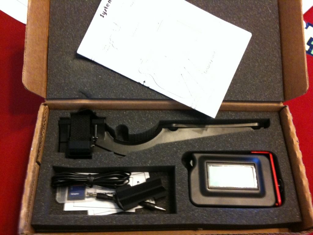

    First impressions
    The construction of the display unit seemed a bit on the flimsy side, but, with care, I believe the unit will last.
    The sensor unit seems fairly sturdy, however like other reviews out there, the units clip latch seems like it might wear out.

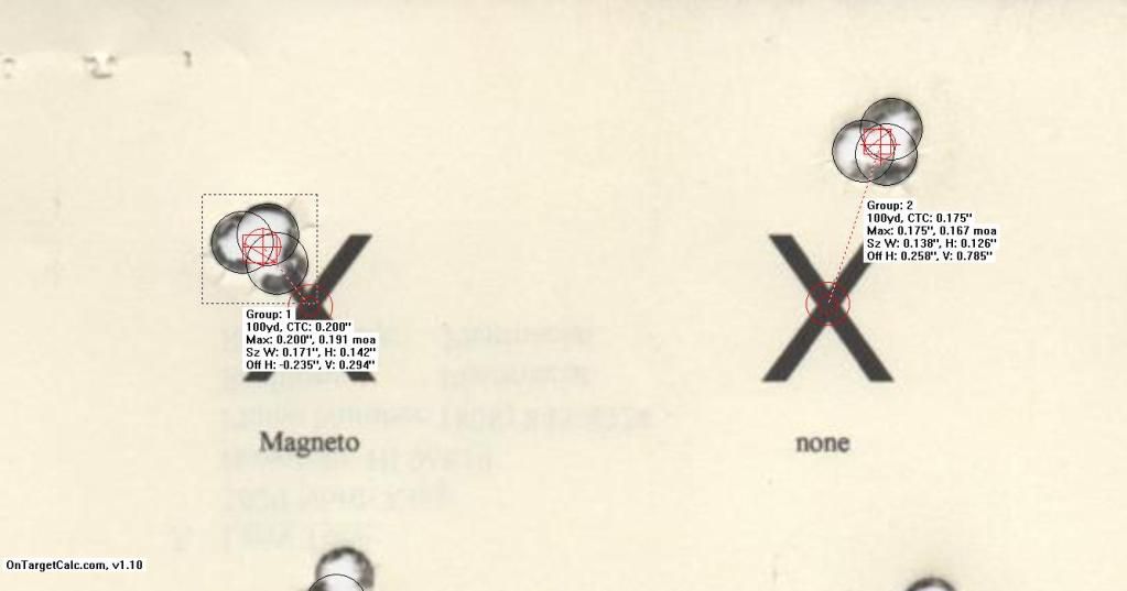

    Accuracy with the Bayo unit attached
    For the first shots, the accuracy of the rounds fired was within the typical patterning of this rifle.  Group size seems to be in line with the typical accuracy of this rifle.  The only change noticed thus far is the point of impact shifting about 3” high at 100 yards with the device clamped at the 6 o’clock position on the end of the barrel.
    There has been debate on the value of this chronograph, on this and other forums, due to the fact that the unit must be clamped to the barrel.  This argument probably has merit, it is known that devices, such as barrel tuners, use extra mass to ‘tune‘ loads and accuracy in rifles.  However, from what I have gathered so far, the un changed loads I have shot has not deviated from the 100 yard accuracy I have typically seen from my shooting ability and rifle.
    Further testing will be done to satisfy my curiosity and determine the practical uses of the device.  So far I am happy with the products performance.  I will update results and data as time and shooting permits.
    These are the best groups I have shot so far with and without the Bayo unit attached.  More data needs to be collected to come to any sort of conclusion.

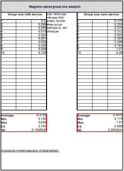

  • Ok,  I finished up my test, of sorts, to see if the bayonet effected groups size.  The procedure I used:
    Loaded all rounds on the same day to get a consistent sample of the ammunition.  All brass was freshly annealed, shoulder bumped .0005", neck sized with the Lee Collet Neck sizer, 'rested' for 3 days, primer pockets cleaned with the Sinclair LR primer pocket uniformer, primed with PMC Russian primers, and bullets (155 grn SMK Palmas)  seated to .040" off of the lands.  The charge was 44.9 grains of IMR 8208 XBR dispensed by the RCBS Chargemaster.  All charges loaded were thrown by the Chargematster unit exactly, any low or high charge was dumped back into the hopper.
    Wind conditions were bad, Very windy.  This, in addition to my poor shooting ability, OK mostly due to my poor shooting ability, accounted for some poor groups.  However, the amount of samplings, IMO, can give a good idea of how the Magneto unit performed.
    All shots were from the prone position from a Mwerks bipod and a Protecktor rear bag.  Wind flags were utilized, somewhat, at the firing line, 50 yards, and at the target, 100yards.
    I shot 10, three round, groups with no unit; I then shot 10, three round, groups with the unit attached to the barrel.
    Here is the worst group with no unit.
    Here is the worst group with the unit attached...
    The best groups are posted in the original post.
    Here is the data that I collected...
    The Average with the unit attached to the barrel was .4126", and the average group size with nothing on the barrel measured .4479".  With such a small difference in the group averages, I believe that the Magneto speed bayonet, attached to the barrel, has a minimal effect on group size accuracy.  With that being said, the unit DOES effect the point of impact on the target.  This shift in POI, for my current 100yard zero, was not necessarily predicable.  With the unit off and on a few times, I noted that once the shots flew 3MOA high, another time the unit shot 1MOA high and to the right .5MOA, and lastly the POI was right on the 100 yard zero, no shift at all.  This, I postulate, is because the unit cannot be attactched in the same place and in the same position all the time, therefore, the POI shifts cannot be accurately predicted.
    I believe that this can be worked around with foulers and sighters that are necessary during load development anyway.
    The chronograph performed flawlessly during the entire session.  No shots went unrecorded, and all data was inline with known data that I have collected for this load.  I believe that this new product can be very useful for the precision reloader.  On a side note, the conditions I shot in today would have rendered my conventional Shooting Chrony useless!
    I hope that this review is useful to all, and Any critiques or comments are welcome. :)
