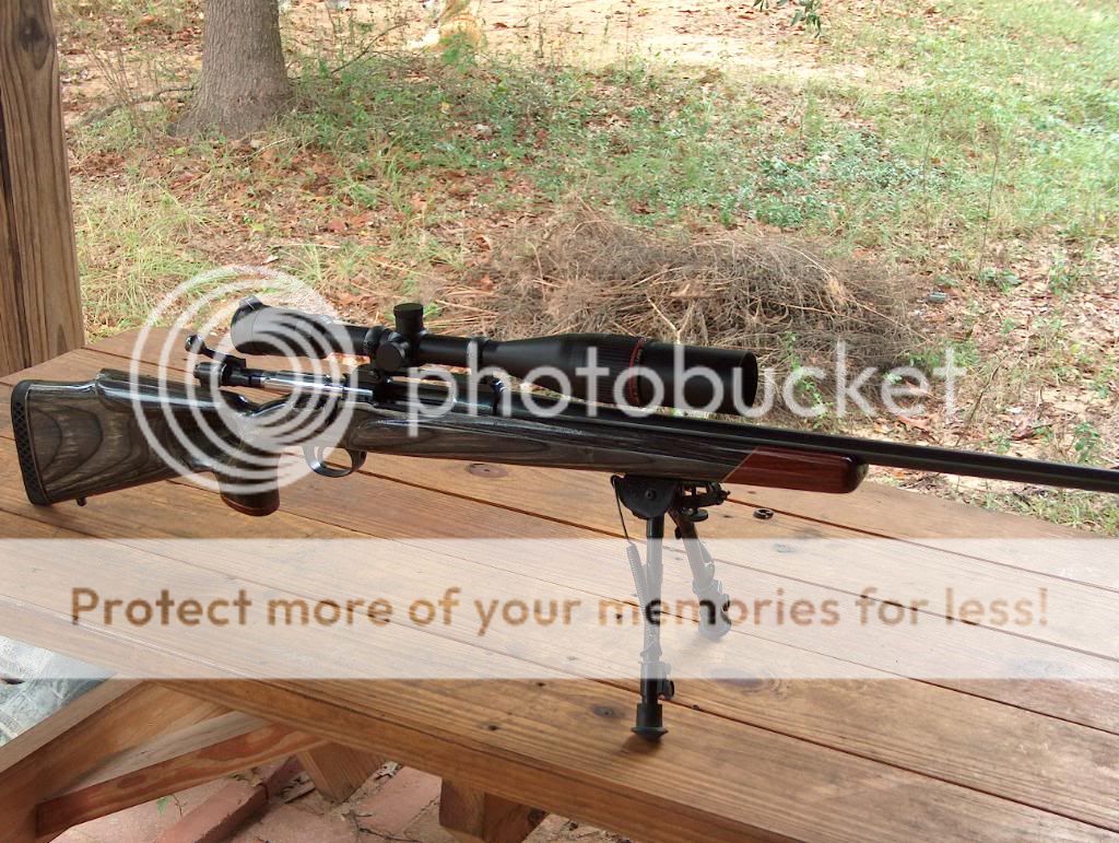

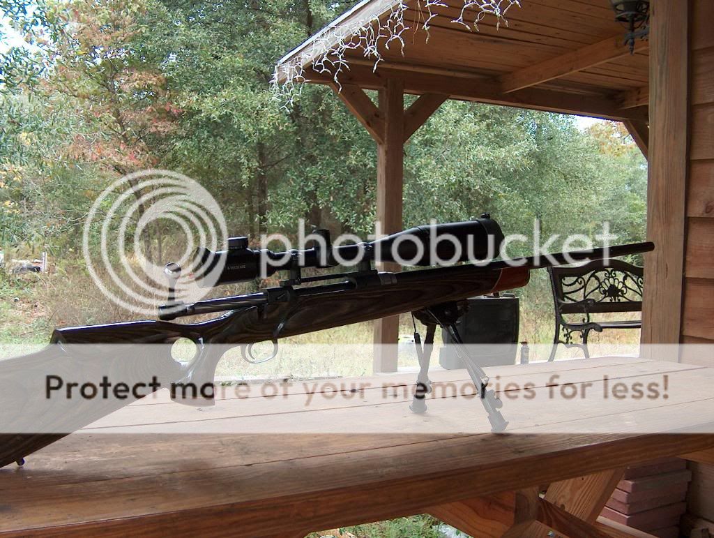

  • Have a .35 Whelan Ackley Improved on a 98 action with a 24" 1 in 12 twist Douglas barrel. Had it throated for the 280 gr. Swift bullets  It is very accurate with all weights to some experimental 300gr. Swifts  Have used it on deer with 225gr. Sierras and they are deadly.
    Don't hunt the big stuff but it would be perfect for larger animals at moderate ranges.
