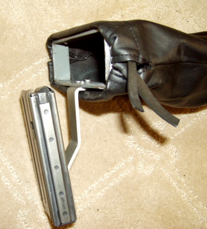

  • I built this unit. It works awesome and nothing attaches to the rifle
