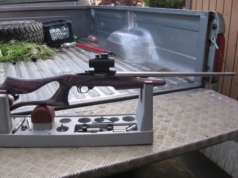

  • This would be a 14 twist 10/22 barrel that was the result of some extra parts, and boredom.
    I put it together for my 12 yr old daughter as a fun gun.  Never fired it with anything but the red dot, and cheap bulk ammo, but it shoots minute of dot.
    Remington meets Ruger

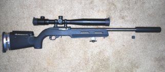

  • My 1 in 9 twist test rifle came about the same way - too many parts lying around, too much time on my hands and a local 'smith that does really great 1/2-28 threads on the muzzle of any barrel I bring him, plus a Yankee Hill can for a .223. Try the Aguila 60gr SSS round in your daughter's 1 in 14" twist barrel; it might work fine.
    Since the can is for a .223, when combined with the unfluted SS bull barrel, the whole rig is pleasantly muzzly heavy, lol.
