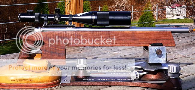

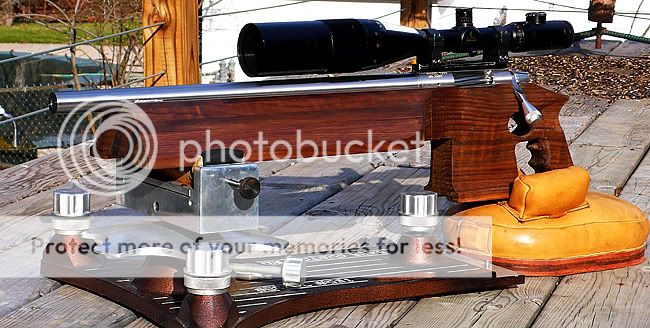

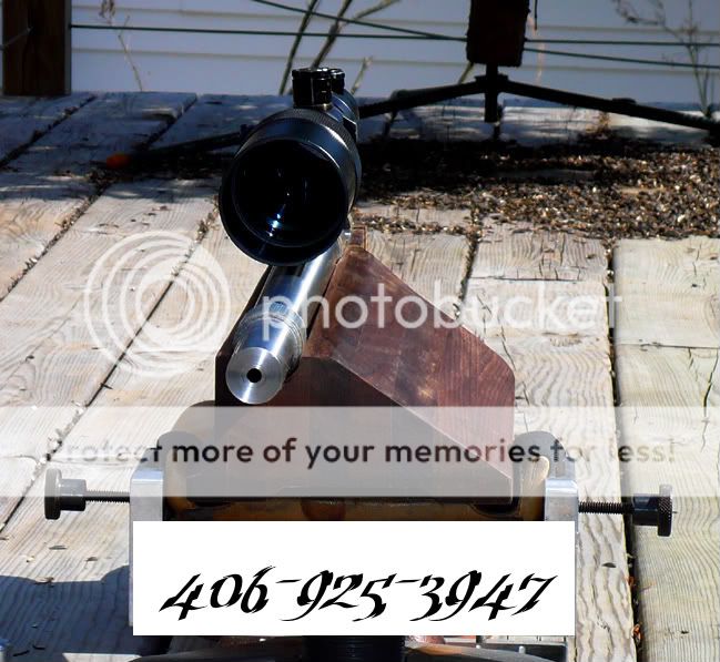

  • After building the 3" stock I looked at the IBS 1000 yard bench rest rules and found out that there was not a width limit and rails were allowed for a Light Gun stock. I set out to design a 6" version. I was thinking it should be offset also to help control torque and track straighter. I had a new 6.5mm 8.5t 1.250 HV taper Krieger barrel. I chambered the barrel for 6.5x284 this morning and bedded the stock. I am planing on putting a brake on the barrel later. Hopping for good weather for tomorrow so I can see how the new design tracks but it looks promising.
    Here are the Pics
