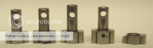

    No offense intended George, but I wish those passing info around would get their facts straight.
    First, the boltheads are made by a outside vendor, Savage only assembles them (ejector-extractor) and are installed.  The assembly stage would be the first "In house" inspection where something like that would have found it way in the trash can.
     The "dishing" is a result of final polishing, tumbling in steel shot and runs entirely across the bolt face. As I said, the larger diameters generally being the worst.
     The occasional cratering issue is a combination of three things, the dishing, a very small amount of chamfering on the edge of the pin hole, a result of the polishing and the firing pin tip profile. The first two conditions are easily corrected with a light facing cut. The third condition is the firing pin tip profile. They're ground on a slight taper with extends about ".025 back past the tip. Since a primer stops the pin forward travel in the .020" range the taper allows a gage between the pin and the pin hole. Re-contouring the tip to a radius allows the full pin diameter to remain in the pin hole on a primer.  Remember, the primer stops the pin forward travel regardless of the static protrusion.
     Two examples, the factory tip profile on the left and one re-contoured on the right.
    Referring back to the fillet at the junction of the shaft and lugs, here are examples of the boltheads used today. Notice the fillet is visible on each and every one.
    Its a result of the tooling used when the shaft and lugs are machined by the vendor. If its not there the bolthead was modified somewhere after leaving the factory.
    Bill
