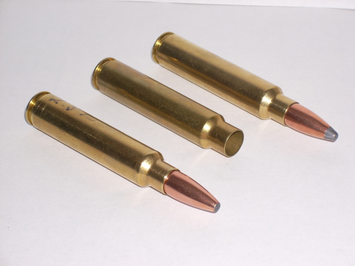

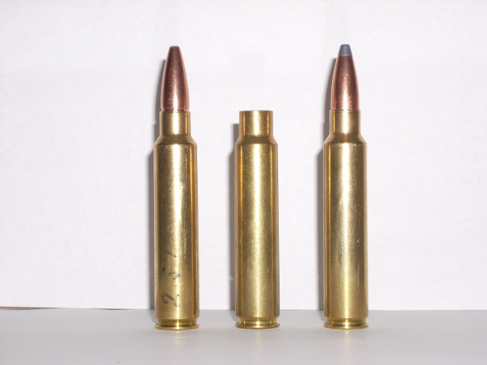

    I built a 338-375 Ruger.
    L - R
    338 Swift A-Frame
    375 Ruger case
    338 Nosler partition
    You are getting faster velocities than what I have gotten.
    However, the design on the case was not extremely aggressive.
    I designed it for a specific purpose in mind.
    I made the neck a bit longer than 'normal' and have more case taper than most would use.
    I got 2710 fps with initial load development with a 250 grain hunting bullet and
    2850 fps with a 225 grain hunting bullet, with the little load development I had time to do.

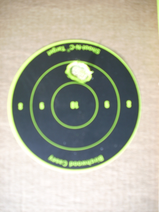

    Both loads are shooting 3 shot groups pretty well at 100, . . . . . and both loads look like this (sorry the photo is not crisp, but you can still see them well enough to get a good idea of the accuracy )  -

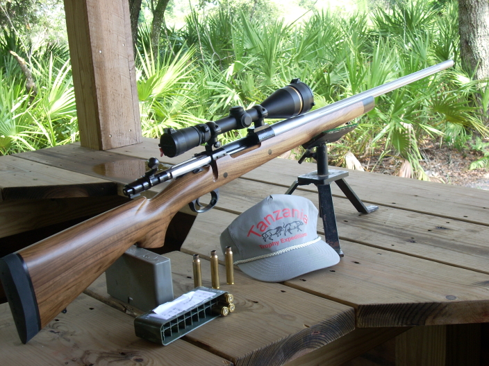

    Here a pic of my Surgeon XL with Anschutz prone stock.
    Steve

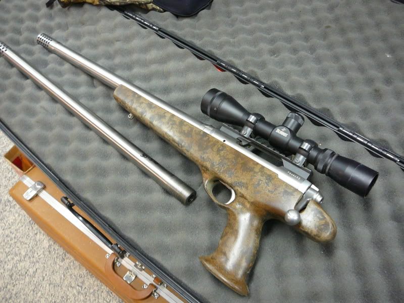

  • Howdy ... I built a 338x375R ... for the 180 to 225 gr bullets .A Savage  Striker ,18" barrel , 10 twist .
    I use 375R dies for the web and bump , and 338 compact mag dies for the neck and shoulder , PTG set up the reamer for me . My 180 gr bullets are at 3000 fps.The other barrel is a 30-338 Win Mag .
