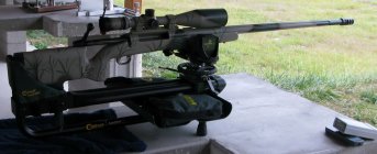

  • Robster,
    Check with Dave Viers.  http://www.viersco.com/
    Dave builds these guns and is an expert with the building loading and shooting.  Dave is also a real good guy and will build you one heck of a rifle.
    This is my 338 Snipe-TAC Dave built.
    Barry
